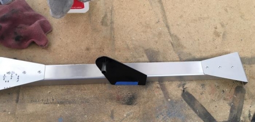

First up was the riveting of the cross-bracket for the torque tube support that goes in the hell hole, supporting the aft end of the tube. I had previously measured and cut the crossmember, but now I had to measure and mark the locations for the triangular end brackets. Postioned them in place and drew a line where the triangle pieces overlapped the crossbar. Removed, clasmped, and drilled. Riveted. Cannot proceed further until I've finished the torque tube install, as all distances are dependent upon its final placement.

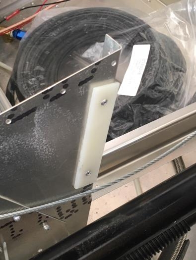

I then riveted a piece of nylon to the inner surface of the torque tube tunnel to prevent chafing of the right rudder cable. Simple matter of place, drill, and rivet.

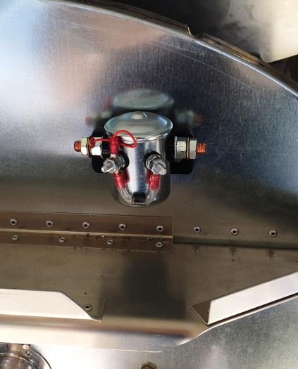

Turned my attention to the firewall; didn't post pictures of all tasks. Dug thru the hardware bins to find AN3 HW to support the master solenoid. Drilled and installed on the upper portion of the firewall. Measured the stud, then drilled and mounted the "forest of tabs" grounding block. This goes thru the firewall; the negative strap of the battery affixes to the stud on the engine side, and abuot 36 tabs are present on the cockpit side for each device to have a dedicated ground connection.
