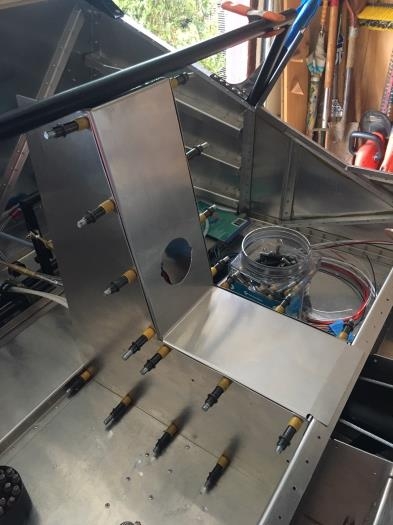

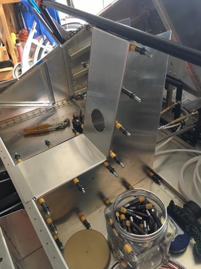

Examined wiring options, because I want to keep the trim controller both on the stick and also on the panel. I'll have to insert a DPDT switch on the console to select between one or the other. Parallel wiring will result in dead shorts due to switch internals.
Was checking out some O-200 parts I had to determine if I needed new piston pins or not. I do.
Installed the full-up console. First time. I wanted to check the clearance between the top of the consoel and the bottom of the panel, as I want to mount the top of the console to the BACK of the cabin frame crossmember instead of the bottom. There should be room if I bend the console top angle just a bit lower.
