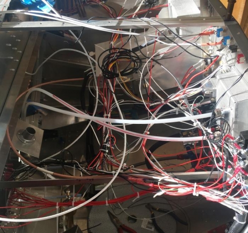

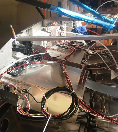

Brief Description:  Start of wiring cleanup
Started grouping wires into cable bundles. A lot of disconnecting from breakers and/or grounding block to get a wire in a straighter orientation or eliminate possible tangles.
Discovered I had forgotten to tie the trim and flaps breakers to the main buss bar.
Discovered I wired the 10ga main buss feed incorrectly; ran it from the master solenoid direction to the buss bar. Duh...how about going thru the main 30A breaker? Rewired that partially; need some 6-32 yellow ring terminals to connect to the breaker tabs.
Discoverd I had not yet run wires for the alternator field from the breaker to the firewall. Made up the cables and installed.
Last night, I thought about an oops I did. I designed the panel avionic stack to be removable; i.e., to remove the screws and it would drop down behind the panel. Well, I remembered that I ran two power leads UNDER the atack, so I removed them and repositioned above the stack so there was no interference.
A lot of cutting zip ties (knew this going in) to re-bundle with new wires.
Left side
Left side
Right side
Right side
