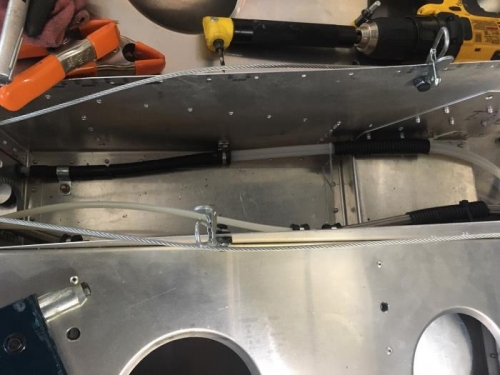

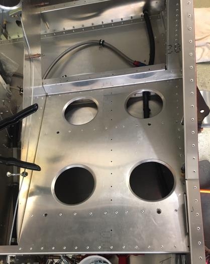

Today was seat base installation day.
First step was to ensure that all FOD was removed, so out came the vacuum and compressed air to really clean it up.
Next, I needed to remove the torque tube to allow access by the riveter.
I installed the seats and was liberal with application of Cleco's to keep it all lined up. Riveted the left side first, if only because it was closer to the fan!
The hardest part was inside the tunnel, if only because there was not enough room for the pneumatic riveter; at this stage in the build, the hand squeezer is getting a little worn, so instead of 3 squeezes and a pop, it was more like 12 squeezes. That, and the left side of the tunnel having fuel lines, and brake lines running right were the rivets were to go was a pain.
Once the tunnel was done, relatively straight-forward for the rest since open access for any riveter.
