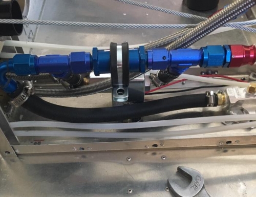

Permanently installed fuel pump - was previously held by cleco's.
Removed and reworked gascolator to manifold flex hose. I had an angled barb coming out of the gascolator, but it just didn't look "smooth." Cut a slightly longer section of hose and replaced the angle fitting with a straight barb fittin. Much smoother with less bending.

Old fitting
Old fitting
smoother, straight shot
