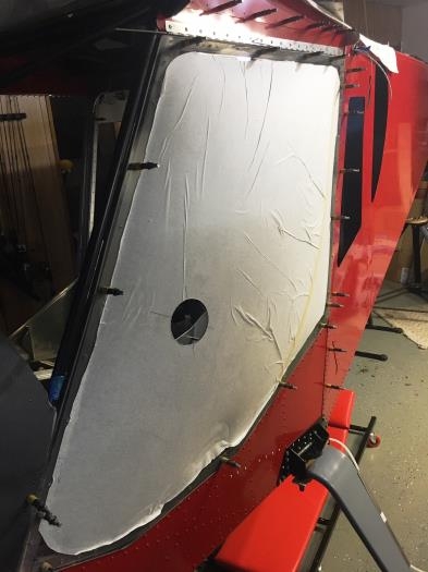

Brief Description:  Fit left door plexiglass
This is the "restart" of the left door. First time around, I cracked the plexi on the 3rd hole to be drilled, so in reality, nothing was done for the left up until now.
Placed plexi on the door frame, then gently drilled all of the holes for future rivets. Traced the dimensions of the right door glass "notch" where the upper rear corner has to clear the 3/16" wing attach doubler. Fit perfect when installed!
Made some mental notes for first areas to be trimmed. Cut the larger corners with a cutoff wheel and the other areas were "finessed" with the belt sander.
One-two more belt sander trips and it should fit just fine.
