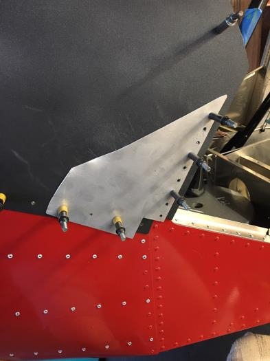

Brief Description:  Drill thru upper panel skin
I made a template as suggested by Jon Croke in the HbH videos to serve as a location for the lower cabin frame rivet points on the aft edge of the upper panel skin.
Cleco'd in place on the lower edge since those holes were established, then back-drilled through the template and into the vertical cabin frame tube.
