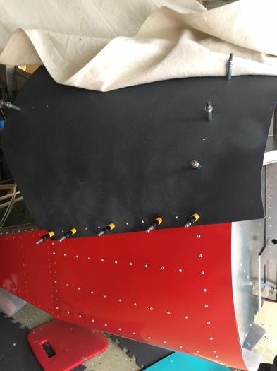

Brief Description:  Fit upper panel to foreward fuse sides
Had a great helper; could not have done it without her - at least as far as getting a goot fit!
I had previously messed up; just got ahead of myself. I had previously drilled the upper longerons for the fwd fuselage skins to #20; they were only supposed to go to #40. When I installed the side skins, I just backdrilled a #40 hole so I could cleco the skins at the time. Of course, this meant I had to back-drilled thru the upper panel skin from under the dash, quite uncomfortable. Made initial holes #40 so I could cleco from behind, then, once all was tight, I could backdrill thru the #20 holes in the longerons thru the fwd skins and upper panel skin. All worked well.
