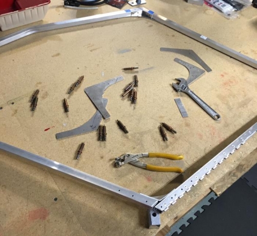

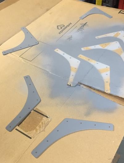

I had previously primed the left door frame. Hung up the frame and started about 3 coats of rattle can gray paint gloss.
Removed the outer corner gussets from the right door and adjusted the bend in the frame to ensure the ends sat flat on the table when the front corner was blocked with 30mm block.
Primed and painted the outer frame gussets for the left door.
