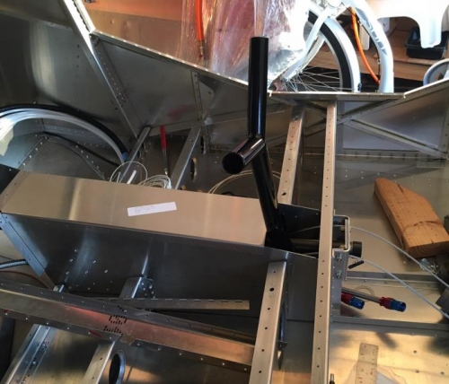

Brief Description:  Working center armrest contents
This is the stage where you do more thinking than assembly. I'm thinking at this point that the fuel lines, pitot/static, and brake lines will go thru the center tunnel area with the fuel lines exiting the existing center hole under the torque tube, and the 1/4" lines (4) will exit 2 on each side at the front of the forward seat support in holes I'll have to drill.
Assembled the Y stick onto the torque tube in order to check swing clearances etc to determine line placement.
I think I have a workable solution....
