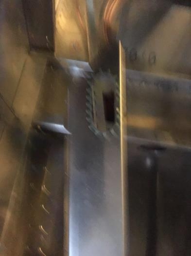

Removed the door sill weatherstrip channels (lower and aft). Deburred the channels and the fuselage surfaces to which they mate. Riveted both left and right assemblies.
The other day I had to enlarge the oblong hole in the left vertical channel to allow the fuel line to pass thru the hole with the grommet edging installed.
Today I removed the right aft vertical channel and enlarged that hole, then installed grommet edging.
enlarged hole in channel plus grommet edging
