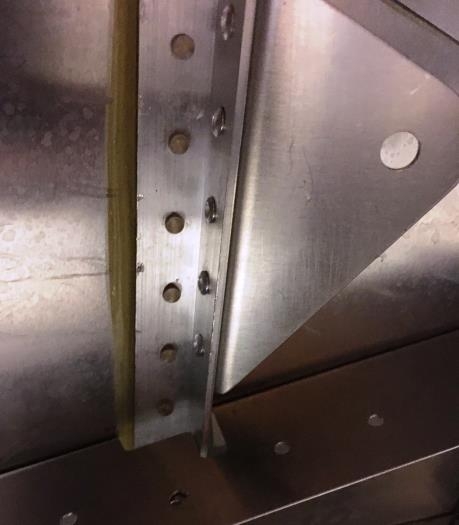

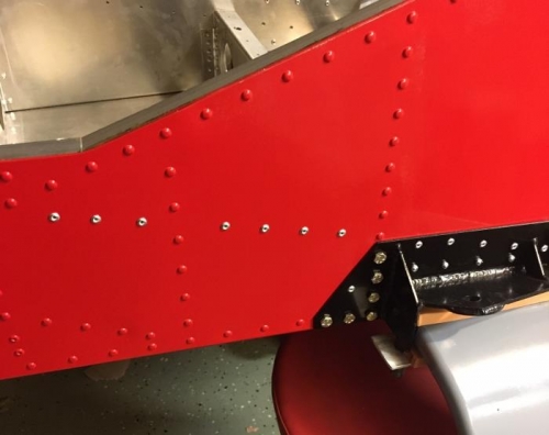

Clamped outboard right seat belt bracket in place and drilled pilot holes. Up-drilled to #20 size for A5 rivets. Deburred.
Repeated on right side.
Riveted the outboard lower seat pan-to-firewall connections.
Cleaned the floor plan from several past riveting events - was getting too cluttered with drill chips.
De-labeled the lower door sill reinforcements and upper door hinges. Measured hinges against the upper sill. Will have to cut to fit.
