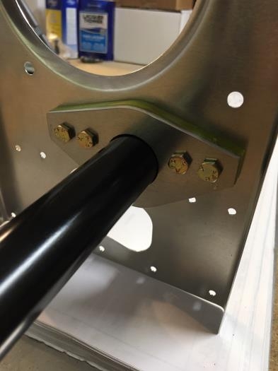

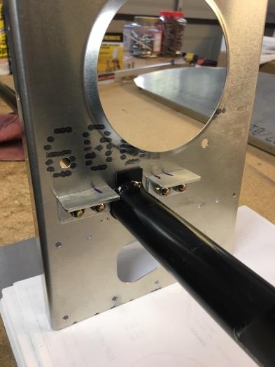

Spent about an hour going-thru the fuel line fittings both from the main kit as well as the FWF kit to see just what I have WRT my fuel line planning. Still need some "T" fittings to support the dual fuel line (L&R) routing I want.
After I drilled the L-angle flaperon stop brackets, I assembled thje front bearing assembly and the stops onto the AFT torque tube bracket. Checked clearance between the L & R brackets and had to remove them to shave just a few thou' off of the left bracket to provide equal spacing for the two on both sides of the torque tube.
Aft side showing flaperon stops
Front side with bearing block
