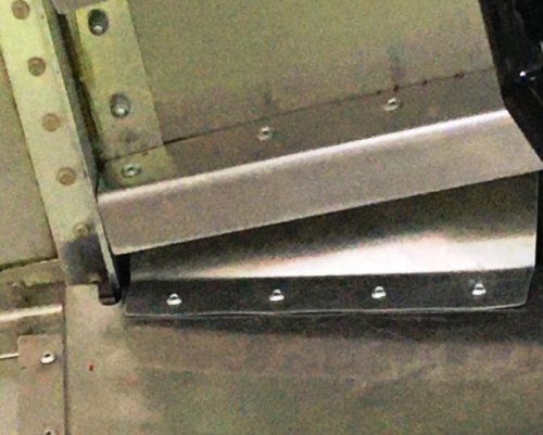

Riveted floor gussets between fwd fuse sides and lower heel support.

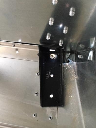

Installed hardware for motor mounts. Spec'd screws, even with thin washer, did not have min 2 threads showing, so had to remove and rework the machine screw chamfer to let it sit a bit lower in the mount.
Upper mounts plans sheets say to use thin washers under the AN3-4A bolts, but could not find any in the Zenith-provided hardware kits. Searched through my spare Sonex hardware and found a whole bag of 'em! Ah, the benefits of being a serial builder.
right lower engine mount (inner)
left lower gusset
left lower gusset
