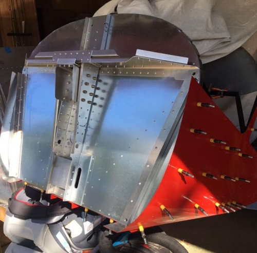

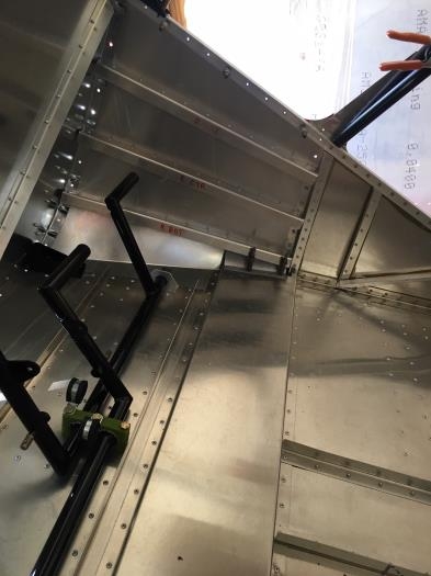

Re-install firewall, fwd fuselage stiffeners
After both MLG wheels were installed, I then reinstalled the firewall in preparation for riveting and nose gear installation.
Positioned the firewall and cleco'd in place.
Installed the 6 (3 per side) stiffener channels and the lower floor pan gusset in preparation for riveting.
Reinstalled all 4 corner mounts for the motor mount.
