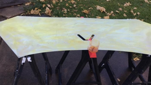

Deburred the upper instrument panel skin. Used a scotchbrite pad and Dawn dish detertent to thoroughly wash the surface, the applied diluted Alumiprep 33 acid etch to the skin.
After the specified wait period, I rinsed off the prep, and, while the skin was still wet, applied full strength Alodine to create a chemical chrome conversion in preparation for painting.
