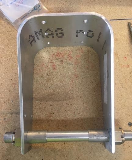

Brief Description:  Drill Nose Gear Fork for Axle
I had previously drilled the two nose strut forks while clamped together. Separated and deburred the holes. Marked the hole for the axle which is 3/4" in size. Hole is 25mm from bottom and 25mm from back side of fork.
Pilot drilled holes. Set up drill press because it's best if the holes are linearly straight. Used a step-drill to take the hole up to size. The step drill I had that would go to 3/4" had a dull spot at the 1/2" mark, so had to switch-out with another step drill (that didn't go to 3/4") for a few steps, then back to the main drill for the remainder up to 3/4" Only issue was that the thickness of the metal was thicker than the individual steps on the drill, so I had to stop short.
Fortunately, the holes were able to be finalized using an edge deburring tool. Axle fits snug and square. Removed part number labels.
