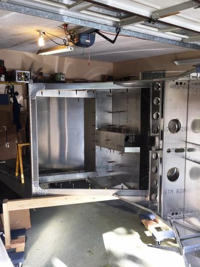

It's been awhile; mostly since we were in KS for 9 days, plus I've been ordering stuff to paint the fuselage.
I decided to roll-on my paint, using Interlux Brightside paint. I decided I needed something low to the ground that could be maneuvered to allow access. I may have already posted this part before.

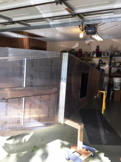

Anyway, today I was cleaning off stuff from the work-side of the bench to allow sliding the fuselage onto the roller stands. I then moved the fuselage (with help) onto the rollers.
Spent some time using laquer thinner to remove all of the mill marks/stampings from the metal. Fortunately, 1/2 the pieces had the marks on the inside, so minimal removal required there!
Rotated the fuselage so the bottom was facing sideways to allow removal of the mill marks.
