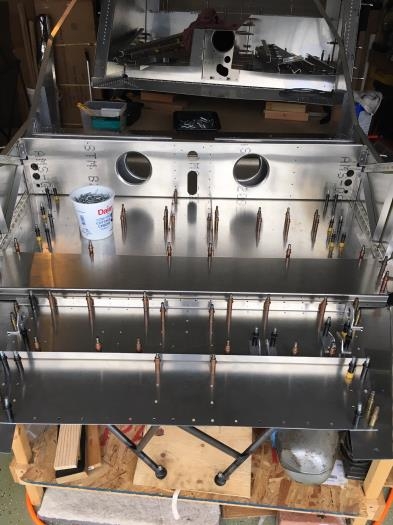

Final steps for rivet prep
Cleanup of final parts; drilled a few holes up to 3/16" to support AN3 hardware for motor mounts and rudder pedals.
Deburred both forward side skins and cleco'd into position.
Next step: rivet the fwd fuse, then re-mate the fuselage.
Ready for rivet!
