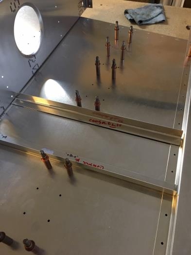

Nothing major done. Time was short, so spent it on continued parts cleanup.
Finished the last forward L angle / Forward Angle piece for the upper right side. Drilled the parts and deburred.
Deburred the lower forward fuselage skin where drilling was accomplished to mount the rudder / brake pedals. Removed the bearing channel and deburred as well.
Cleco'd the forward seat support and floor stiffener in place and measured for the two pieces of L angle used on the bottom flanges of the optional center console. Still have to drill them.
Console base angles
Console base angles
