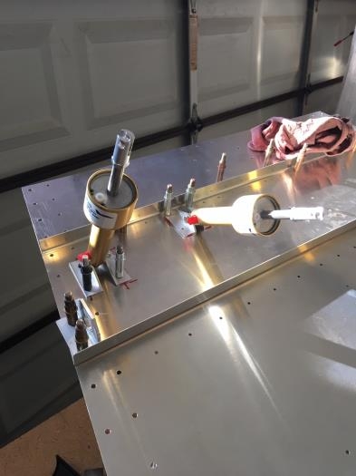

Brief Description:  Finish rudder pedal fixtures / deburr / fwd side c
Measured and positioned angles to hold the brake master cylinders. Had to file-down the upper curve of all 4 pcs as they were interfering with the cylinder attach points. Clamped in place, then up-drilled to #20 for A5 rivets. Cleaned up the pieces; removed red marker lines and de-labeled the parts.

brake master cylinders sitting in position
