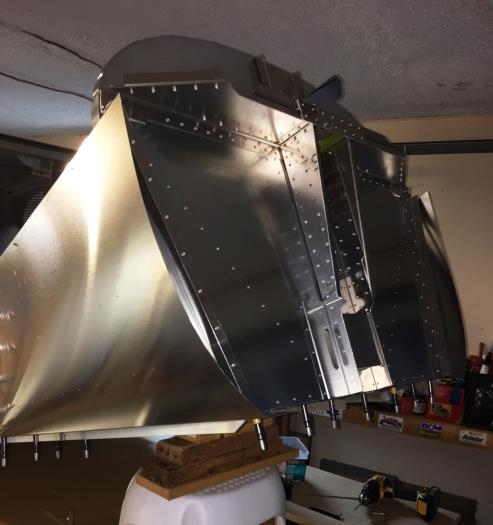

Brief Description:  Drill-out foward skin; mount L skin, mount firewal
Spent a bit of time researching plans and pictorial guide for how to proceed. Specifically, rivet call-outs. Adding the sliding seats have some plans superceding other plans, so had to do a lot of back and forth.
Proceeded to drill-out the allowable holes in the right forward skin; mostly in the areas of the lower longeron attach points, around the heel reset, etc. Drilled some holes that had no pilot hole, specifically left that way to allow for build variables.
Installed left forward skin; tacked in place with #40 cleco's; will have to updrill that tomorrow.
Installed the firewall just to make sure nothing got dramatically whacked out of line; it's now only held-in with #20 cleco's along the lower edge, which were pre-drilled both on the firewall and the lower side of the fwd fuselage skin. Had to take some pics and make engine sounds.
