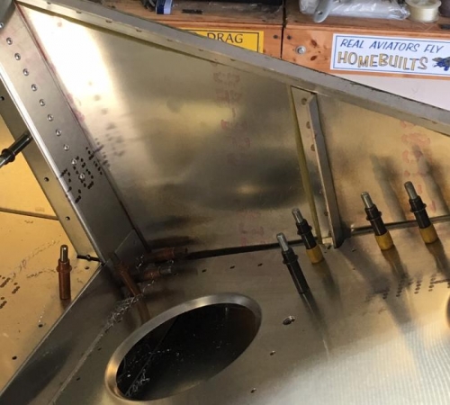

Holes drilled for seat base side connection

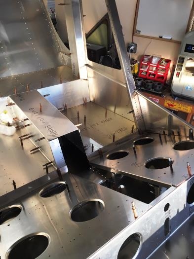

final fitment / side rail support
