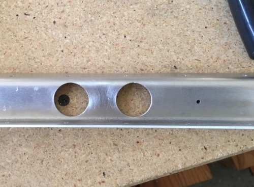

Drilled 4 holes in rear seat support rail (2 ea side) to allow fuel lines, electrical, pitot-static, etc., transit from the aft fuselage to the forward. Once the seats are install, there's no penetration from rear to the front. The holes shown in fig 2 below will have grommets to prevent chafing.

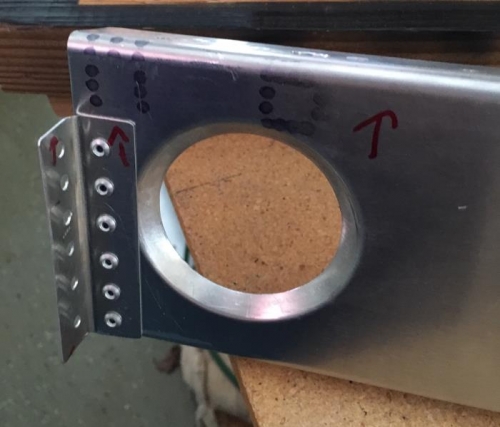

Riveted a section of L-angle to the rear seat support SSO-2 to allow mounting to the armrest side panel.

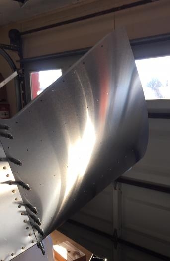

Installed the forward-most side skin to the fuselage lower and upper longerons
inner corner brace for SSO-2 riveted
fuel, cable, pitot static line holes drilled
fwd skin cleco'd in position
