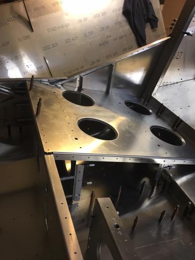

Picked up where I left off last night.
Drilled the L-angle to fit betweem the side skin and top of the gear channel. Up-drilled to #20 for A5 rivets.
Updrilled some other holes in the fwd fuselage to #20 for the sliding seat option. Up-drilled some holes along the lower longeron line to final #20 size as well. Temporarily installed right seat base to see how it will look, but also to ensure correct fitment.
De-greased & removed protective coating on the gear weldment and then painted it. Did not powder coat this part because community wisdom says that the coating will hide any developing cracks.
Deburred the rear sliding seat support and riveted the inner L-angle brace to the support.
how the seat will look installed
