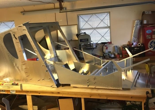

Brief Description:  Prep for fuselage mate
Lots of little misc tasks at first; updrilled fuselage bottom skin to L-angles, updrilled L-angle corner braces to #20 and #30 depending of whether they're part of the sliding seat option or standard fuselage assemblies; clean-up.

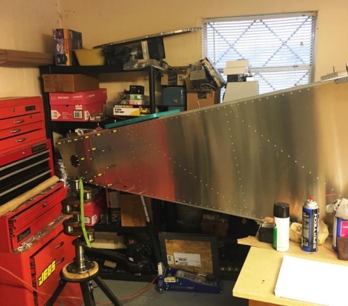

Rarranged shop a bit. Pulled the table out from being parallel with the wall to a diagonal. Slid the aft fuselage back to the corner (almost) and placed the fwd fuselage on the bench in prep for mating.
Had to trim both sides of the lower corner longerons on the aft fuselage as they were jutting-out a bit and I didn't want to get the fwd fuselage slid in there only to discover they had to be trimmed. Took some cutting a a lot of filing to get things smooth.
Now to wait for some muscle to come help!
fuselage rearranged on bench
...lest you think I have lots of room...
