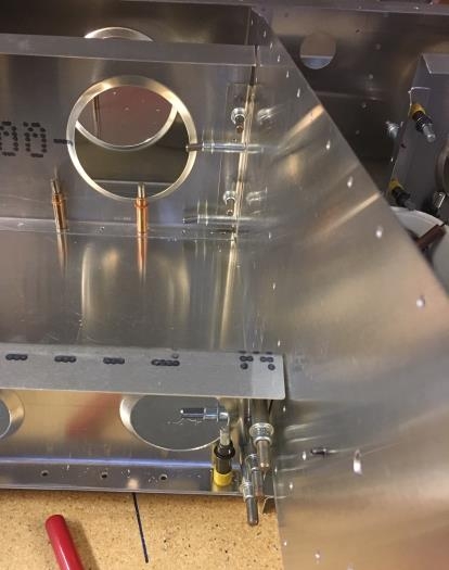

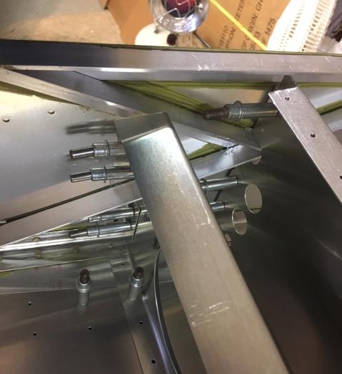

inboard L angles installed
outboard L angles installed

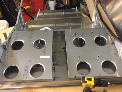

Both seat bases for comparison
