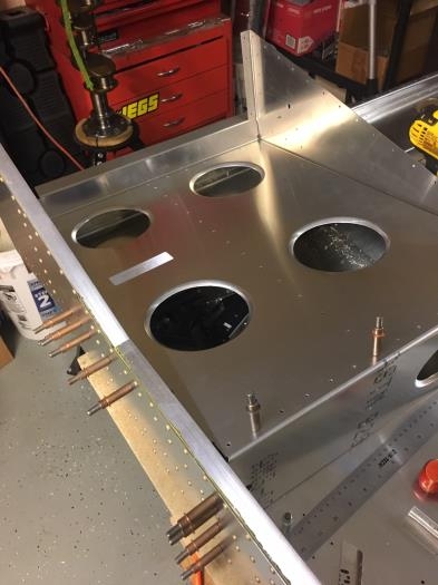

Aligned the right side of the fwd fuselage to be plumb. Locked in place with clamps. Installed pre-made L-angles shown in pic 2 below. Back-driolled thru fwd seat support and cleco'd into L-angles.
Drilled fuse side flange of rear sliding seat support, locking alignment in place.
Fabricated L angles for inner junction of rear seat support and right armrest and pilot drilled and installed.

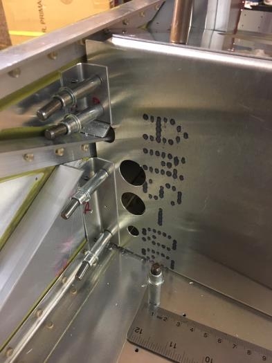

Did a lot of R&R/Trim work on the seat support shown in pic 1 below. Had to trim the sides a bit, which was noted by the HomeBuiltHelp videos.
