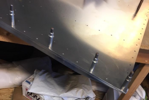

Managed to squeeze in a few minutes on the forward fuselage longerons.
These were pre-cut to the correct length, but needed to be pilot drilled for placement along the edges of the fuselage.
Additoinally, had to trim-off angle cuts on both ends for spacing reasons.
Cleaned up the parts, clamped in place, then proceeded drilling to #40 holes thru the holes already placed in the lower skin of the fwd fuselage.

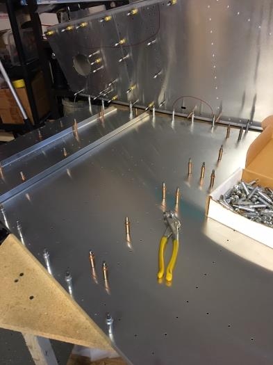

Orientation pic of longeron cleco'd in place
Just showing both sides cleco'd
