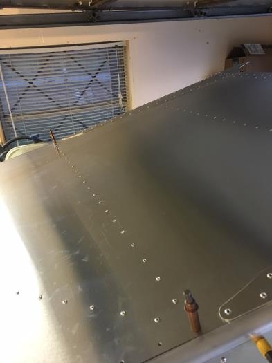

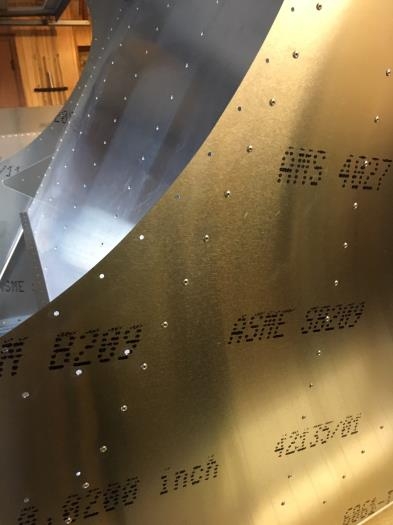

Finished riveting the upper skin to the top of the front crossmember. Cleaned up the rivet stems and drill shavings from the past several days work. Vacuumed-out the aft fuselage before things get closed-up.
Deburred and delabeled several small parts like gussets, seat belt anchors, etc.

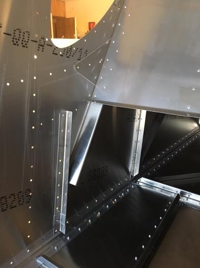

Riveted the upper baggage back to the upper skin, then riveted the side channels of the baggage back to the fuselage sides.

Baggage back sides riveted
Gussets and L-angles ready for tomorrow
Last rivet row is baggage back
