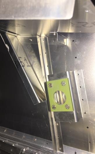

Finished prep of flaperon mixer control tube and 4 control rods for the flaperons - 2 vertical that connect the controls to the wing, and two horizontal that connect to the pilot yoke.
Deburred the end brackets for the flaperon control tube; included debur, label removal, and attachment of green bearing material onto the brackets. Fastened by 4 AN3-5A bolts.
Had to fabricate two L-angles that stiffen the fuselage wall underneath the flaperon brackets. Finished the left side, about 75% on the right side when our son came over with pizza.
Had to do some research because I thought the brackets went in differently than portrayed in the plans. All is good now.
Bracket fitted under baggage shelf
