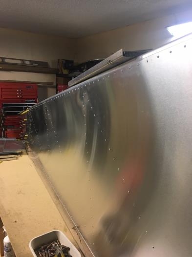

Riveted the upper side portion of the upper fuselage longerons, both left and right sides.

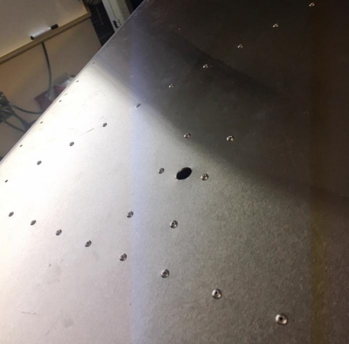

Picked a spot, measured, and spotted the hole for the eventual ELT antenna. Didn't want to buy the ELT at this point since it would be out of warranty before the plane even made it to the hangar!
Cut a doubler plate, measured mounting holes, and installed on the underside of the aft fuselage upper skin.
Upper longeron riveted
Spot for ELT antenna
