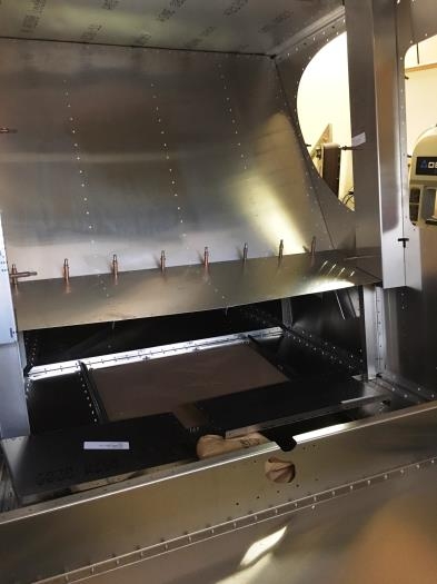

Didn't spend too much time today on the project.

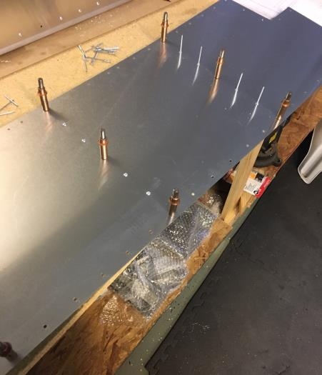

First step was to reinforce the small baggage floor. Cut L-angle raw stock, deburred, and clamped into position below the pilot holes in the floor (pic 1). Pilot drilled, updrilled to A4 rivet size, disassembled and deburred, then riveted.

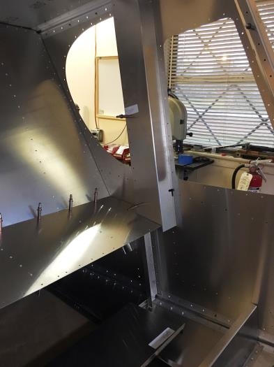

Next step was to fit in place. Clecod to the baggage back, then positioned the flaperon pushrod covers into position. Had to remove some parts to get in easily, then reinstalled.
Next up will be to cut 4 small L-angles to reinforce the floor against the flaperon cover.
baggage floor being reinforced
flaperon pushrod cover in place
