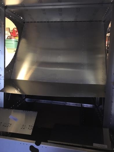

Finished drilling to #40 the stiffener L-angles to the baggage compartment back wall. Up-drilled to #30, then riveted the side supports, stiffeners, and baggage angle at the top that connects to the upper fuselage skin. Deburred before riveting.
Riveted the upper front crossmember parts. This involved riveting 9 # A6 rivets (the big ones), followed by using #20 A5 rivets for the rest of the crossmember assembly. Cleco'd back into fuselage.
Slid the upper / top skin into position and worked the vertical L-angles under the fuselage longerons. Cleco'd into position.
Riveted baggage back & baggage floor

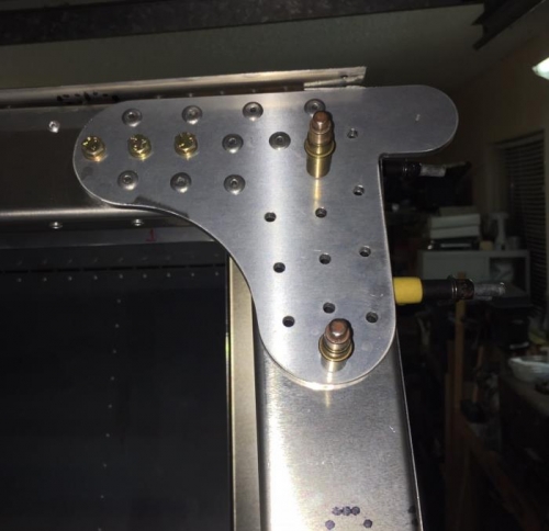

Wing attach bracket
Wing attach bracket
