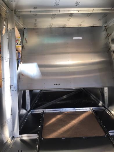

Deburred baggage compartment back wall components. Cleco'd together and cleco'd into position in the fuselage. Had to adjust the fit of the side rails where they overlap the upper fuselage longerons.

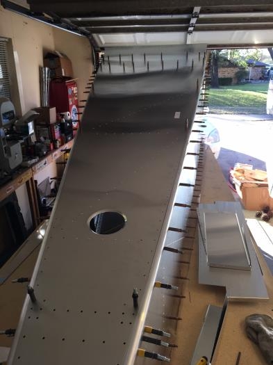

Installed top skin panel and drilled holes thru the baggage compartment angle at the top of the wall where it meets the top skin. Top skin pre-drilled, so just had to run a drill thru those holes into the wall angle.
Removed the top skin and riveted the last L-angle. Last week I was uncertain whick way the angle was to face, but another builder suggested turning it around so the flat part rested up against the flaperon control box. Looks good that way. Cut L-angle stiffeners (3) for the back of the baggage compt wall. Cleco'd into position. Drill died, and it was getting late, so I just have to finish drilling a few holes, then up-drill them to #30, then deburr and rivet.
Top panel in place
Top panel in place
baggage back wall
