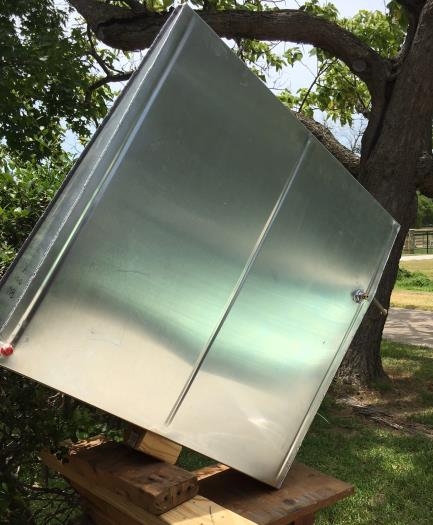

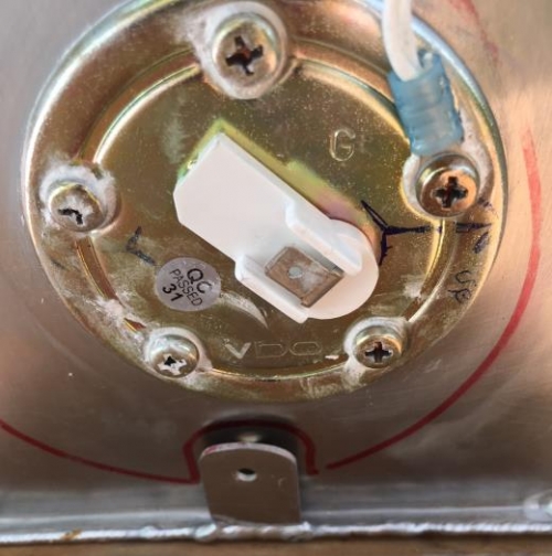

I had previously drilled the fuel tank for installing the fuel gauge sending unit. Today I installed the sender and attached grounding wires to one of the lugs.
I cut-down the square head of a pipe plug that seals off the fuel return line location on the tank. Installed the fuel drain. Made up a temporary plug to seal the fuel supply port. All this because for the other tank, it was hard to test for leaks when most of the open holes would allow fuel to escape. This time was better, but still had two leaks (big one around the fuel filler hole cuz I didn't seal it with teflon sealer. But, after putting 4 gals of fuel in there, the sending unit did not leak (pic 2 in the as-tested position). Put the "test" gas back in the can for use in my lawn tractor.
