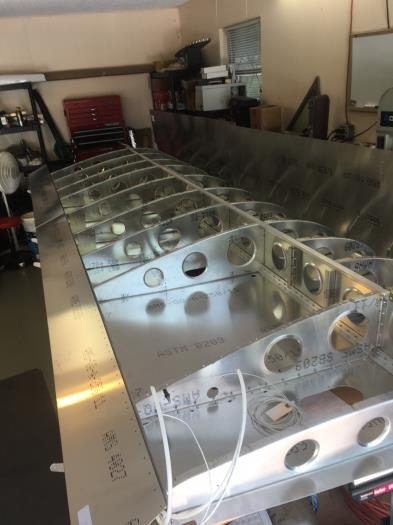

Brief Description:  Rivet Lower Skins - Left Wing
Lengthy time spent, one task: Rivet lower skins.
Included main spar, rear spar (including trailing edges), and all nose and aft ribs. Had to stop and fill riveter with oil - first time since brand new.
Flipped wing right side up. Still need to measure / install flaperon brackets, fabricate L-angles for the flaperon brackets, install strut fitting, install some adel clamps to protect pitot/static lines, and install upper skins.
All riveted

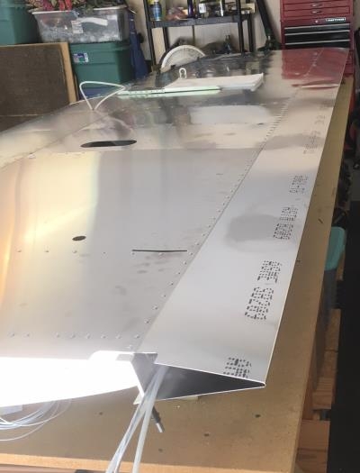

All riveted

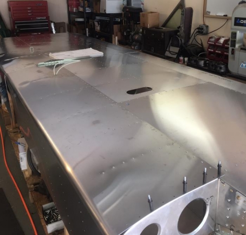

Flipped right side up for upper skins
