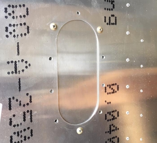

First up was to install some nutplates on the inspection hole covers I drilled and counter-sunk yesterday. I had some left over from last build, so didn't dig out the Zenith-supplied parts (same thing though). Installed 5 nutplates on each cover, as I only had 10. Since these use 3/32" rivets, I had to dig out my old Arrow riveter as that was the only one I had that would handle the narrow stems. Had to open-up the screw holes as they were exactly 3/16, which lead to the screws threading themselves into the holes - just a hassle.

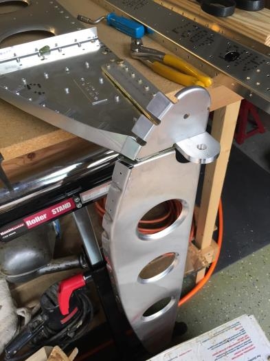

I then figured I had some time left, so I cleco'd the inner root rib and root nose rib into position; these also require the remaining 2 A6 rivets and it was a pain doing this after the other ribs were installed (just angle/access issue). As with the right wing, where the nose rib meets the L-angle already in place to support the upper root skin, I had to file some relief notches in both the L-angle and the base of the nsoe rib. Rivet will come tomorrow or the next day.

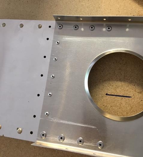

left outer tip extension installed
added nutplates to covers to keep the bugs out
Inner root rib cleco'd in place
