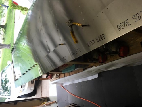

Brief Description:  Test Fit fuel tank; test fit trailing edges
Dug out the right fuel tank; removed wrapping and gave it a visual check. Dropped it into the tank bay to see how much room there is for cork on all the sides. The left and right side will probably each need 3 strips of cork; other than that, a single thickness should serve just fine in the other areas.
I test-fit the trailing edges. Sharp eyes will notice that although I properly installed on the bottom edge (edge goes UNDER the aft skin, OVER the rear spar), the top side I just left on top. Oh well, no rivets, no foul. Sorry; didn't edit the pics to rotate them right 90 deg.
