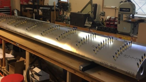

Moving to the outer skin with the new knowledge in hand, I positioned the straps and got the holes to line up well enough to cleco. Again, a cleco in every hole.

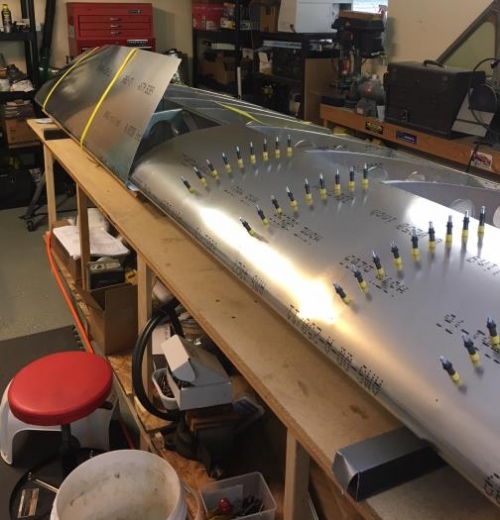

Lastly, I installed the aft upper skin (remember - I previously riveted the L-angle stiffeners in place) and cleco'd just enough to line 'em up and keep it from sliding. More cleco's to follow.

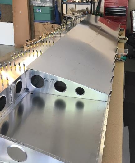

The order is a bit different from final assembly, since the pilot holes for the main spar are only in the aft skin. As a result, the hole-less nose skins get placed first, THEN the aft skin, so that the builder can drill thru the aft skin (sized at #40) thru the nose skin, and into the main spar. These holes (a bunch of 'em) are then progressively up-drilled to #30, and finally #20 in prep for an A5 rivet. Once drilled, all is disassembled, deburred, then RE-assembled with nose skin on top, and riveted.
Inner skiin cleco'd
Inner skiin cleco'd
both skins cleco'd
both skins cleco'd
aft skin just set in place
