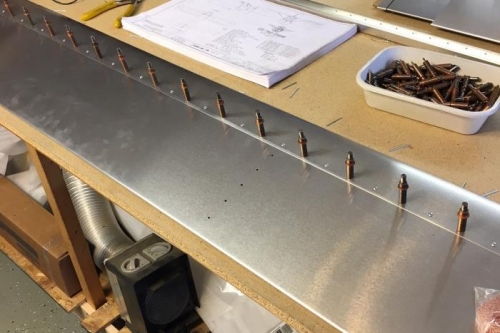

Brief Description:  Just about finish up Left Outer Flaperon
Riveted the top side of the left outer flaperon; turned it over, braced it, and folded the leading edge skin over with the help of my assistance. Cleco'd and riveted. Installed flaperon splice plate on inboard edge that will ultimately connect to the inboard flaperon. All that remains is to rivet-on the white ABS flaperon tip.
Underside Leading Edge Riveted
