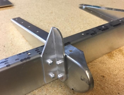

Relatively straight-foward. I had previously cleco'd the ribs in place and had fabricated the flaperon pivot/mount brackets out of 1/8" extrusion.
All of the ribs had to be up-drilled to #20 where they mount on the spar; they came from the factory only to size 30. Riveted the ribs and two nose ribs. The inboard end rib does not get riveted at this time; a bracket has to be installed before this is done.
Clamped the pivot/mount brackets and drilled thru the spar & ribs at #40. Updrilled to #30, then finally to #20. Riveted.

Detail of control pivot
