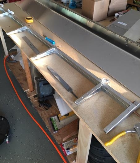

Date:  2-4-2018
Number of Hours:  0.80
Manual Reference:  C75-AA-1
Brief Description:  Debur / fab flaperon parts
Started the 4 flaperons. Started with the right inner. There's inner and outer on each side, making 4. Aside from end ribs / connections / actuators, the airfoil part of each is the same.
Deburred parts; cleco'd together. The kit ships with 65mm long L-extrusions that serve as the tabs for mounting on the hinges. These have to be cut on the diagonal on one side and radius'd on the other to fit within the skin.
That's it for today.
Deburred, Cleco'd, ready for rivet
