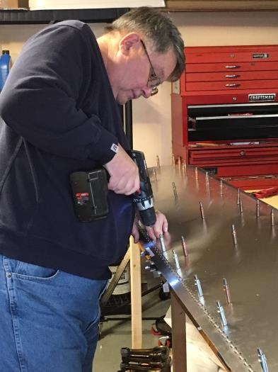

Brief Description:  Drilled elevator hinge
Inserted elevator hinge between stabilizer skin and aft spar. Clamped. Drilled thru hinge (one of the rare, undrilled, parts in the kit) and secured with 3/32" cleco's. Updrilled 1/2 of the holes to #30 and cleco'd those with 1/8" clecos. Battery in drill ran out, so called it a day.
FAA wants to see builders doing hands-on
