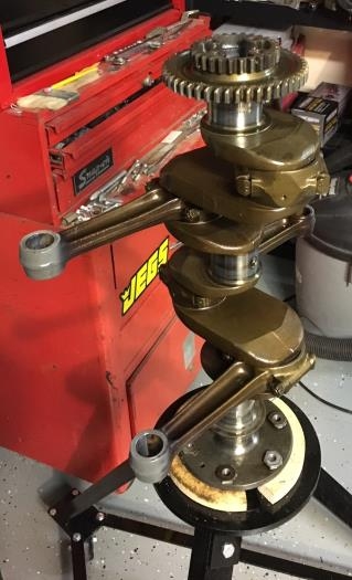

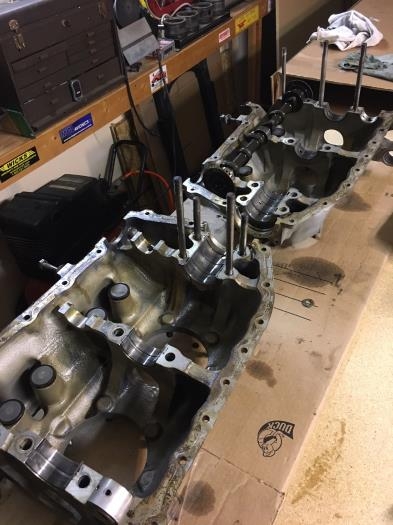

#2 son then helped me separate the case halves from the crankshaft. Extra hands were needed to keep the camshaft from falling out on to the floor.
Initial quick inspection showed the engine to be in what I consider excellent condition. No obvious scoring of bearings; lifter bodies and cam lobes all consistenly smooth pattern wear.
Need to contact Aircraft Specialties to see about shipping the ferrous parts for magnaflux inspection.
