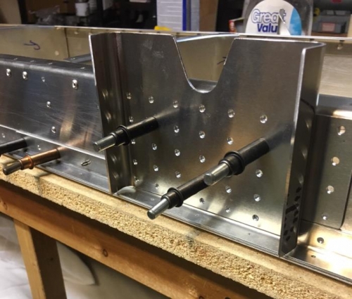

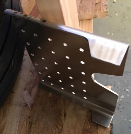

Next, I obtained an electric 3" cutoff wheel a few days ago as well. I used this today to trim the aft spar attachment bracket. For reference, the first pic is a repeat from the other day. Remember, the top of the picture is the bottom of the horizontal stab. The tabs that stick up will be fastened to the aft fuselage attachment points much later down the road. Since the elevator will need to be fitted to this side of the spar, the side pieces must be removed to provide clearance. Pic 2 below shows the trimmed, deburred, and radius'd piece.
