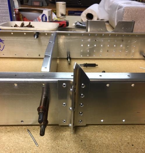

Front Spar, Inverted; Mount tabs

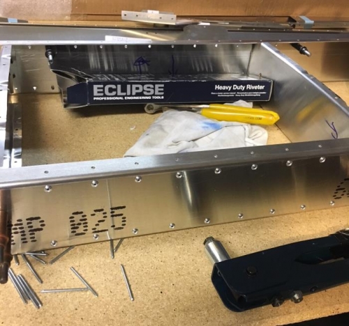

Row of rivets with manual riveter

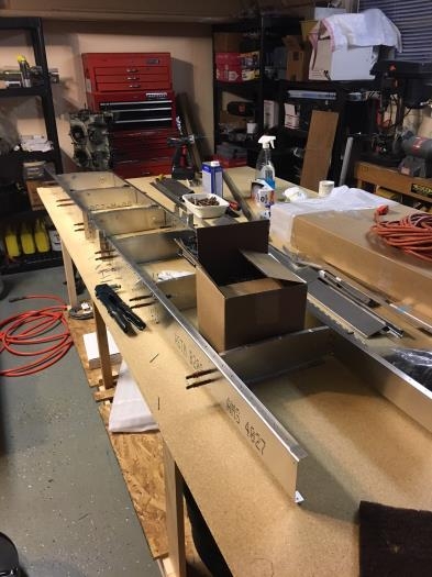

Overall Aerial View
Overall Aerial View
