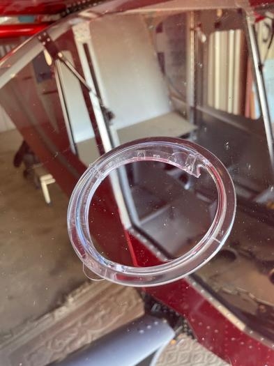

Installed snap vents in the door glass. Tried a few days ago, but I was not wanting to push them further, fearing that I'd crack the window (big $$$). It was a warm day today, so I put the vents on the back window of my car (tinted, so it was dark, i.e., hot) and they went in. Still had to flex them quite a bit, but overall felt better about it.

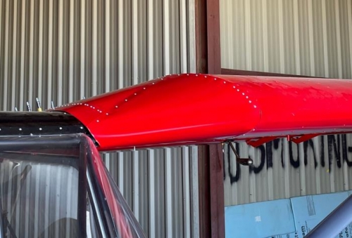

Lastly, I finished riveting the top front half of the left wing inner root skins.
