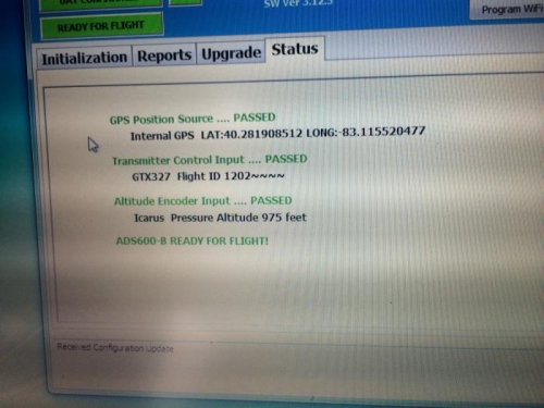

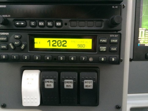

I knocked out a couple of punch list items over the last few days. They were easy enough to fix, but troubleshooting and isolatnig the problem took awhile. Renee assisted me in ohming out the wires.
I now have the proper altitude encoder output going to the transponder and the ADS600-B transceiver. Also the tramitter control circuit from the GTX327 transponder to the ADS600B now works as well.
I also upgraded the ADS600-B to the current software release.As you can see from the photo, it's ready to go.
