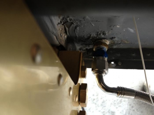

Started the day getting ready for the restest of the fuel flow. Janice helped me with the test.
The first tailed failed due to builder error. The connection to the left tank shown below was overlooked. You don't get much fuel flow when the fuel is flowing the the ground. I had to react quick, plug the hole, and get the line installed.
The good news was once the line was installed, the fuel flow test went perfect. No clogged lines.
The paasing mark for the fuwl flow test is 64.35 ounces per minute. The left tank's flow was 98 ournces and the right was 112 ournces, well above the minimum flow required.
